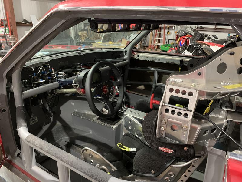

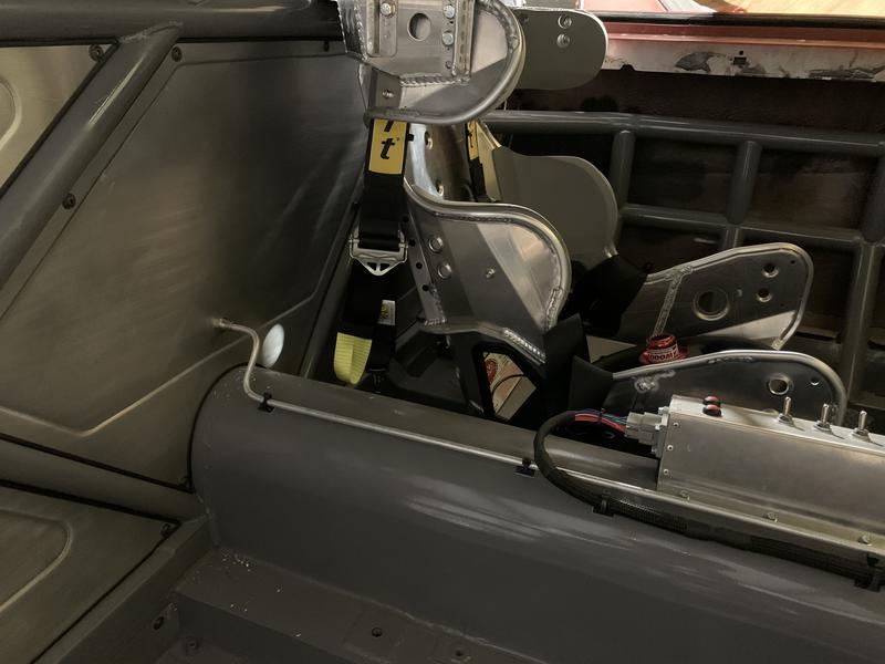

Quote from: Ron Sutton on Apr 12, 2026, 01:34 PMThat seat is awesome. One thing Oval track racers do better is prepare to protect them selves WHEN they crash. Too many "Track Car" guys think it won't happen to them, because they're not planning to push the car 102%. Which is rubbish. A crash at 100mph is a a 100mph crash, regardless of intentions.
I caught myself saying something like this. Had to give myself a little pep talk about it basically as soon as I said it. Noone ever "plans" on crashing. It always happens fast and you have no control over it, hence, "lost control". Someone told me to buy the best safety equipment you can afford, and I've tried to make sure I do that.

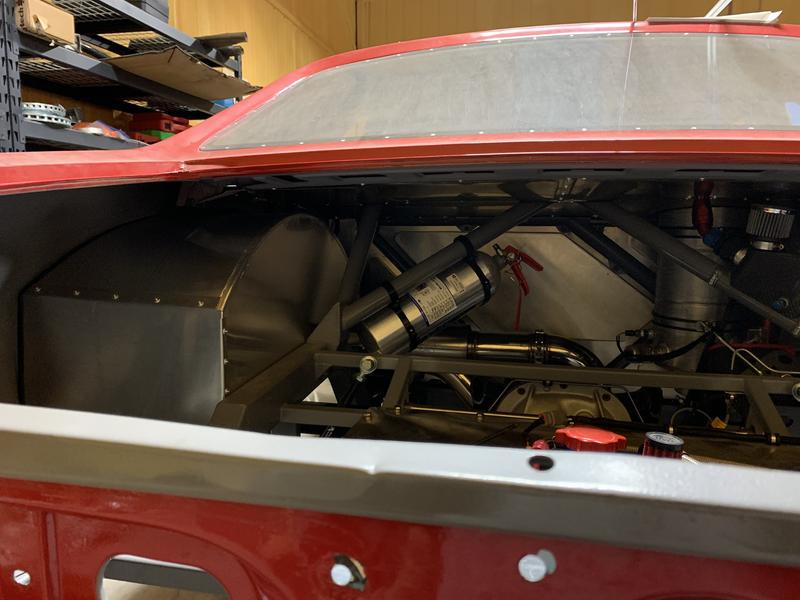

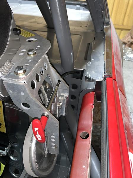

A carbon HANS would be nice, but a fiberglass HANS will still save your life - you need one even if its not the best of the best. Make sure and install harnesses correctly. Fire suits are expensive anyway you buy them, so buy the best one you can. Fire extinguisher is better than no fire extinguisher, but you can't really use a handheld extinguisher effectively between the moment you realize you're on fire and the moment you're able to do something about it. I'll do a post on my fire system and harnesses. I think I did them as well as I could have, but its a good topic for discussion.

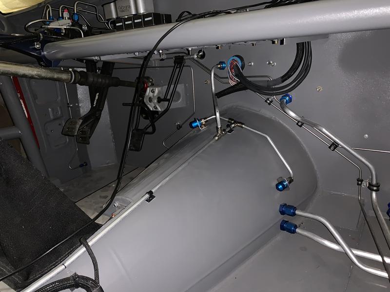

Quote from: Ron Sutton on Apr 12, 2026, 01:46 PMI am a fan of the both the Fuel Lab brand & Radium Engineering brand of Top Plate systems with Fuel Cell Surge Tanks.  They only cost a little bit more money than running the square collector in the bottom of the tank.  They pickup more fuel, increasing how far we can run on the same number of gallons.
FuelSafe told me the Radium Engineering brand is hard to get sometimes. So they use the Fuel Lab brand more.
Deatschwerks also did their own version with a fabricated aluminum surge tank that serves as a top hat for the cell as well, so there's definitely options for keep it all contained in the cell. External surge tanks are also an option.
I helped a friend make an external version for his car since he was having starvation issues. It incorporated a box style in the cell to an external surge tank the fed the primary pump. The fuel return from the rail ran to the surge tank and then the surge tank had an overflow back to the cell into the box style internal surge tank. Extra component or two, but he really liked his hat and primary pump setup and didn't want to change it. We were able to make the external surge tank to a size and shape that worked best for the space available. Worked great! Solved the starvation issue. Didn't do anything more for using every drop of fuel in the cell, but doing time trials with short sessions on track, it wasn't an issue.
